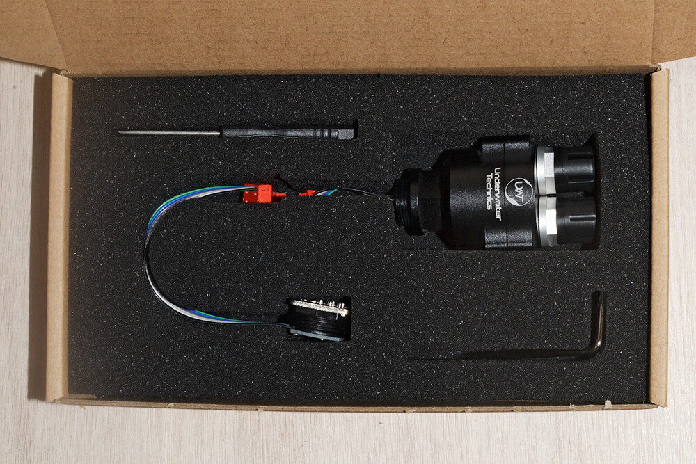

UWTechnics supplies a small 2x0.5mm flat-head screwdriver with every product. Here is the photo: This is a very popular flat tip size. It can be purchased at most hardware and auto parts stores. Please note that the rotary switch shaft is made of soft plastic (easily damaged with the wrong tool). It's best to use a standard small 2x0.5mm or similar size screwdriver.

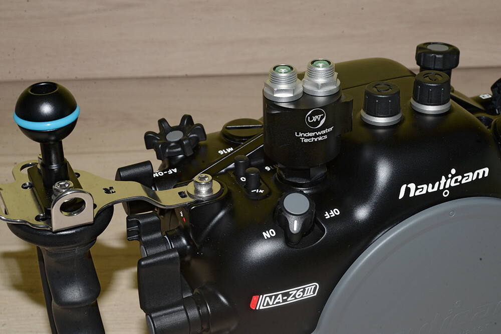

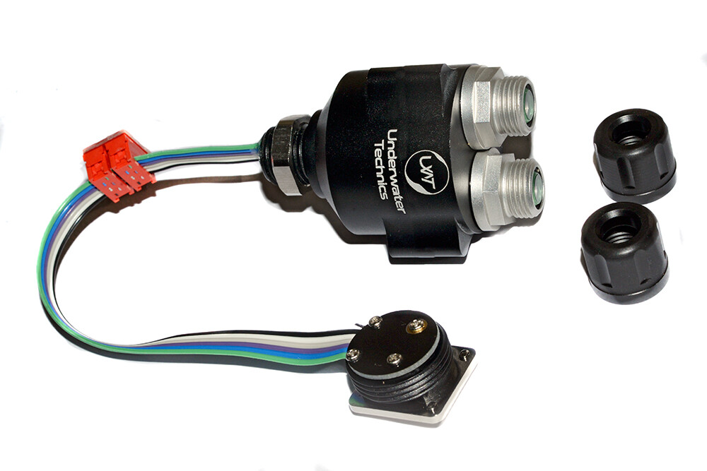

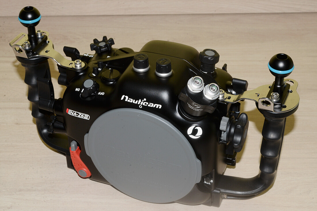

The installation and functionality of UWTechnics External M24 TTL Converters on the new Seafrogs aluminum housings has been successfully tested. UWTechnics TTL converters with M24 thread (Sony, Nikon, Canon, Olympus) fit perfectly into the M24 hole on the top of those Seafrogs aluminum housings, without interfering with external controls. The metal bracket also eliminates interference. The connection to the camera (inside the housing) is also comfortable. The installation on aluminum Seafrogs housings is very simple and secure, the same well as TTL Converter M24 installation on Nauticam and Marelux housings. So, now the TTL and HSS flash control is available for this housings line, supporting the most popular strobes on the market: Sea&Sea, Inon, Retra, Marelux, etc. This information may be useful for Seafrogs users.

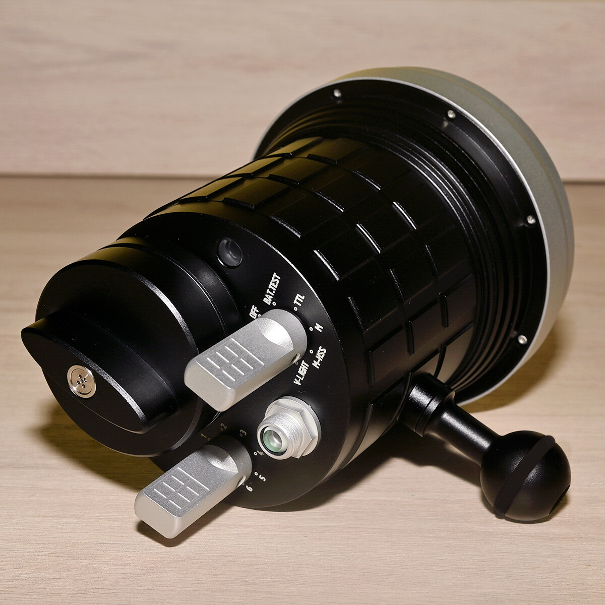

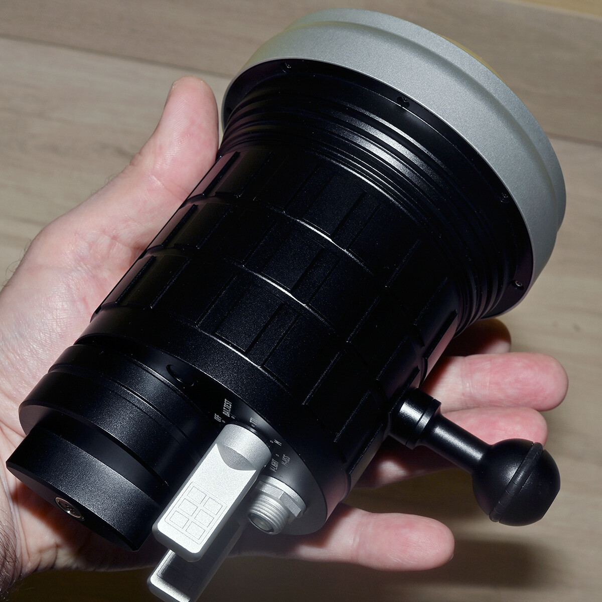

NEW strobe / videolight OPTIMA-10000 from Underwater Technics.
This is a new product, still in development. Technical delays are possible. However, it will be available soon.

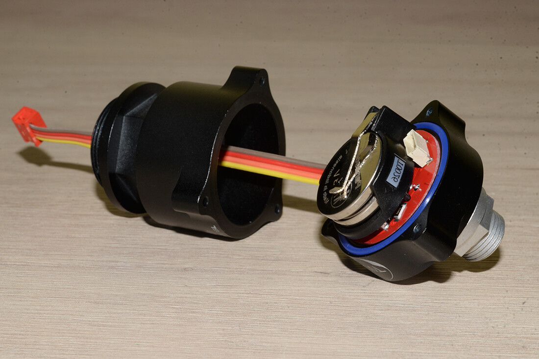

It looks like low battery, or weak contact in the battery holder. Remove the product from the housing. The next actions do on the table, without housing and other gear, but only with the camera: Remove the batteries from TTL Converter. Bend down the central tongue of the battery holder pushing it maximum down by any tool (flat screwdriver), to improve the contact. Then, install 2 batteries. Batteries must be NEW. Check the "flash" symbol on the service screen and the LEDs work. Set all camera settings described in the User Manual of TTL Converter for TTL mode, carefully step by step (this is absolutely necessary). After the TTL flash tests on the table directly with the strobe (without fiber cable!) you can install the product into the housing and connect your cable.
