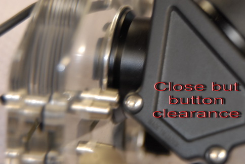

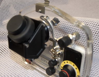

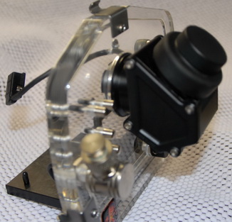

  7. Well I took the plunge and purchased a INON 45 Viewfinder. They didn't have one to fit my Ikelite housing so I was on my own. No big deal it's just money right? Well I am a handy guy and after the order shipped I began looking for Delrin to make a adapter out of. Well after it arrived I began thinking of how this could be done. I could adapt it to go one externally but it could also fall off. So after days of thinking, drawing, measuring and planning and erasing and trying different things I had a plan. So out to the shop I went to work with the lathe and micrometers and delrin. Slowly it took shape, and after 3 revisions I am quite happy with the results. I think I can do this for about $250 if anyone else needs a Ikelite adapter. Take a look at some of the pictures, The housing was not modified and can be reverted back to stock in-case I plan to sell the housing. I want to thank everyone in this thread for the information, pictures and links.
