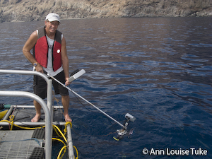

  7. so from that description, Version 2 of polecam will need to have the release button in-line, on the pole rather on the the monitor. With my low-tech, no monitor version, I have the release taped/cable-tied to the pole under my right hand.
    Even with my no-frills version, Polecaming is more easily managed by 2 people.... passed to you when you are in position, taking it from you when you need a break, and depending on the length, moving it around the boat with housing attached. Awkward.
  8. so from that description, Version 2 of polecam will need to have the release button in-line, on the pole rather on the the monitor. With my low-tech, no monitor version, I have the release taped/cable-tied to the pole under my right hand.
    Darren - The release in-line on pole is already an easy option, with or without monitor. In this photo you can see how it is triggered with remote mounted in receptacle on pole, under my right thumb. You can even run video goggle off the monitor if you wish, and trigger either with button on monitor, or remote cable release.
