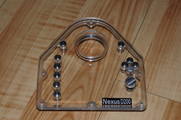

  1. D700 was put into my modified D200 Nexus housing today.
    It seats properly on the base plate (same center line as d300)
    & front and top controls are in line. Back cover was closed & was
    in line with D300 controls. Basically, same size as D300 except
    'big' top prism box(still goes into housing).
    Sam

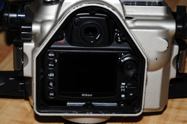

  3. When I receive my D700 on 25 July, I will make my housing
    working with it & test the camera. My first impression was I
    felt like I am holding my F100 camera. I also, took few test
    shots & looks very good.
    Sam
    pic shows back cover closed & back controls are same as d300.
    Lens shows d700 has same center line as d300

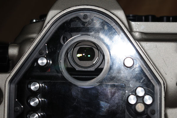

  14. How well did the viewfinder line up, Sam?
    It's cool that it fits!!
    thanks...
    Linda
    Viewfinder is little off but, good enough to use it 'as is' . I will post a picture later today.
    Sam

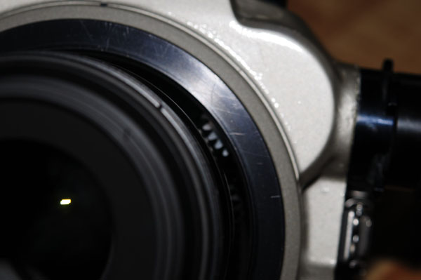

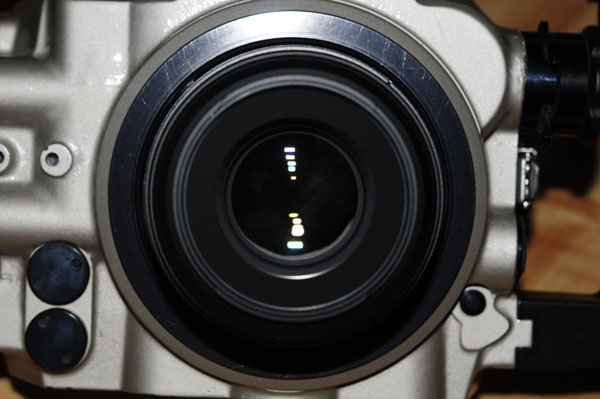

  15. O.K. Now I have an update.
    1.Camera & lens perfectly in line with d300 base plate I made earlier.
    I also, tested 16mm lens with dome & shows no vinetting.
    2.Picture shows 105mm vr lens with manual focus gear. working fine.
    Sam
  16. View finder is not in line. However, I can see full view finder/screen as is now
    & have no problem to take housing underwater & take pictures today but,
    I will be making new window, too.
    Both f-stop & shutter speed dial works fine as is, too.
    There is new 'info' button & will try to make one extra button for it, too.
    Sam
