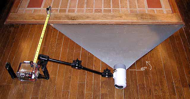

  13. strobes are designed to emit a certain beam pattern. understanding this beam pattern may help in strobe placement~aiming options. for instance, a DS 125 spreads a 100° beam pattern with diffuser installed.
    if you take some construction paper, scissors, and a protractor to create a shape similar to the beam that your particular strobe throws, it may lead to a better understanding in strobe aiming options while minimizing the capturing of backscatter.
