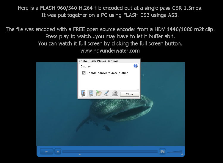

  5. Update 2
    Well after spending quite abit of time testing out different encoders to make FLASH H.264 clips, I think I have found a good one.
    If you go here you can see the results....remember you need the latest FLASH player to watch it.
    http://www.hdvunderwater.com/flash_H.264/HD.html
    Specs:
    FLASH - 960/540 H.264 file encoded out at a single pass CBR 1.5mps.
    It was put together on a PC using FLASH CS3 - AS3.
    The file was encoded with a FREE open source encoder from a HDV 1440/1080 m2t clip. (gee I luv PC's)
    The encoder specs can be fully customized and best of all it maxed out all 4 cores on my 3.2 ghz QUAD PC when encoding....yep that's 100% on all 4 cores.
    Considering the low 1.5mbps it's encoded out at and how hard blue water is to encode, it looks not bad....watch it full screen.
    My beautiful wife shot it all while snorkeling.
    I'm still fine tuning the encoder for even better results.

    Using the average setting it will encode out a 960/540 H.264 file from a 1440/1080 m2t file faster than real time.
    Don't forget to set your FLASH 9 player to Enable Hardware Acceleration for better full screen performance.
