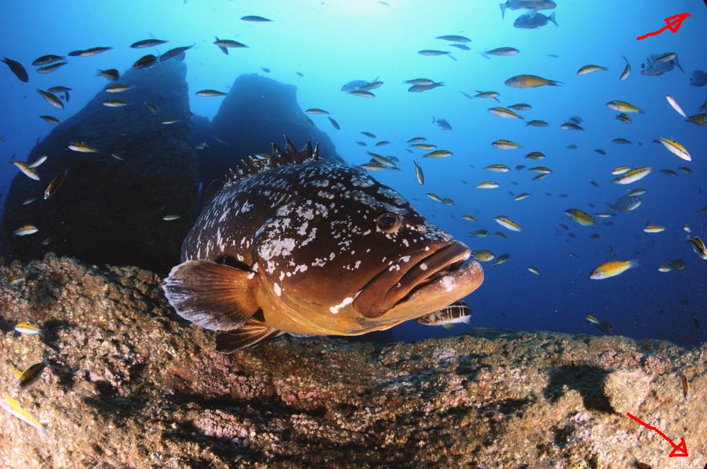

    I need a help for this situation:
    All my pictures with the Tokina 10-17mm are problems in the right corners, only in 10mm focal lenght. (I add photos for you see the problem).
    This is very strange because the left corners are always OK.
    I use the Tokina 10-17mm with Nikon D300 in Subal ND30, DP-FE2 port and Ext 18mm.
    Where is the problem? The lens, the camera, the housing, the extension or the photographer?
    Thanks in advance for your help in this bizarre situation.
    Best regards,
    Tigershark

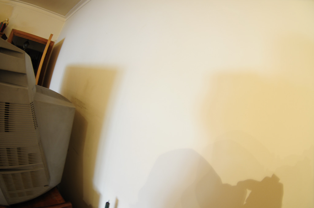

    With the help of one tape-measure I have detected the problem.
    In fact the lens are out of the center, to the right more or less 1,5mm. (Is the same for all my lenses)
    I take the measure from both sides of the lens in the housing ports mount ring.
    Anyway the camera are in the right position on the support saddle, if you mind what I say.
    I go tray fix the problem.
    Thanks everybody for your help.
    Best regards,
    Tigershark
  14. Solved for now.
    After half day of hard and amateur work this is the result.
    Now is good, but I think there are some problem with the saddle.
    Let's go see what happen in future.
    Best regards,
    Tigershark

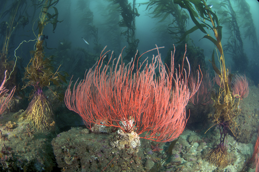

  16. 3rd day of a 3 day trip. My dome shade on my FE2 port was slightly rotated. All horizontal shots had vinegtting in the upper right corner. When the dome shade is on correctly I don't get this effect. Vertical shots were unaffected. This was shot with a D2Xpost-72-1217476161.jpg
