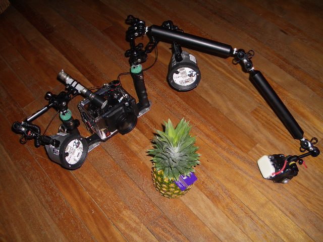

  1. I've a two weeker coming up and I'd like to try some backlit macro shots. I have two Z-240's as my 'prime' stobes on 5" arms and I have added a back facing YS-25 on 2 x 12" arms. If I may benefit from your experience and short circuit the learning curve... Many thanks.

  2. I'd be curious to hear others' advice on this as well. I gave this a try once on a boring dive with some small sea fans. Unfortunately got some nasty backscatter. I thnk should have spent more time getting the background exposed properly, maybe move the backlight strobe down further (out of the frame?) and dialing it down quite a bit or pointing it more across like your setup.
  3. Yup, that close backscatter is the enemy... give it a try an tell us.
  4. I've tried shooting backlit seafans in UK waters and have found the best results to be from using a single strobe to backlight the subject from an oblique angle . Add more strobes and backscatter increases.

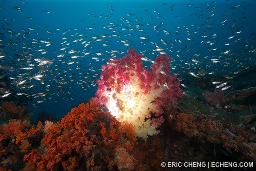

  5. I find backlighting a tricky technique and it usually requires quite a lot of fiddling to get right. I would suggest using the backlight strobe unattached - rather than on an arm t get the flexibility you want. I find a lot of trial an error is required for each subject. But it is worth persevering because it is a good way to enliven a relatively ordinary subject, such as this crinoid in Thailand.
    Subject selection is important. Generally you want something that does not move and has a hairy or polypy appearance - to accentuate the backlighting effect.
    Alex
  6. I agree with Alex. I like to use an unattached strobe as a slave for backlighting. I use an INON Z-220 as my slave.
    Edited by echeng
