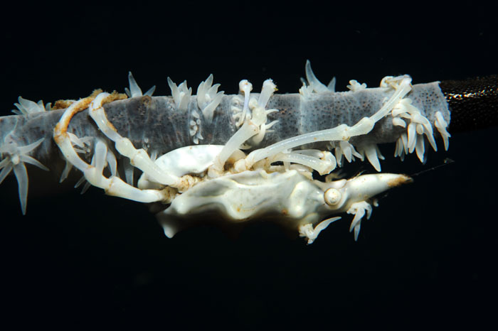

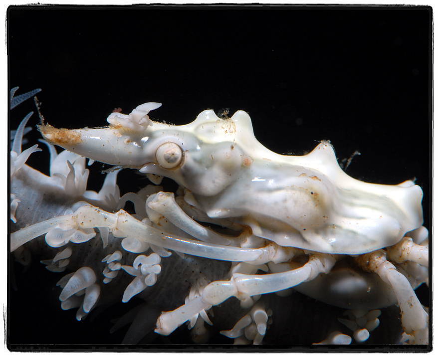

  5. O.K. you can see the difference of DX vs. FX.
    First one with 105mm VR in d700.
    Second one with same lens in d200.
    and choice is up to user. I prefer flexibility of
    d700 as I can choose 'dx' mode or crop the
    picture in camera if I want more details. I did
    not have same flexibility in d200/d300.
    Sam
