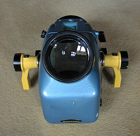

  8. I think my Hasselblad housing's viewfinder is too large. :offtopic: I'd rather have something smaller and brighter, than that. Although you can look through it with both eyes simultaneously! But more important would be to have one that it isn't reversed left to right!
    Edited by Alex_Mustard
  9. I think my Hasselblad housing's viewfinder is too large. :offtopic: I'd rather have something smaller and brighter, than that. Although you can look through it with both eyes simultaneously! But more important would be to have one that it isn't reversed left to right!
    I withdraw my comment! :P
