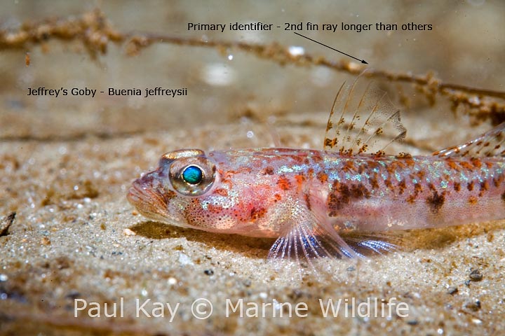

  10. I'm a great believer in using as appropriate lens as possible. Given that fish don't hang around, zooming might just be another step which might just lose a shot. As an example I've attached an image shot a week ago on a fish survey. I've highlighted the relevant point which the image had to show in order to be useful in the particular survey. Such images do not necessarily need to be at all artistic and selecting a lens which is capable of capturing the detail relevant to the job in hand might be a useful way to go. FYI in this particular case the aim was to look at 'small' fishes of 2~10cm in length and the 100mm Canon macro was ideal on my FF camera.
