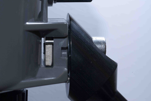

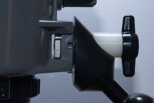

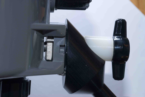

    OK all you Inon strobe owners
    I have checked both my Z240's and have found that one of the spacers on my UCLS adaptor had worn and the 'O' rings have compressed enough to enable the screw to come into contact with the strobe body
    I ground a few mm off the length to give some clearance
    Alternately I've fixed the adaptor with a stainless M5 20mm long Allen screw
    I think that this is the best option
    Hope the above is of use, and as I've already said "It's better to be safe than sorry"

    I have a small correction. I just replaced my mount screws and you need a M6 x 20 (not M5). I like being able to secure it with a tool rather than usring the thumbscrews (one of which broke on me).

    Nice solution. I lazied out and just used a couple of washers. My Inon/ULS dealer warned me of this problem when I purchased the Z240's.
