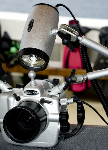

    1. Here is what the strobe looks like, shot taken on Seven Seas live-aboard:

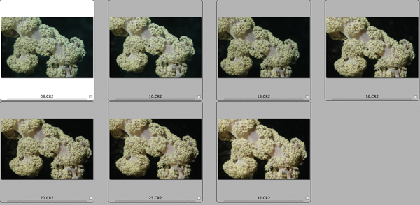

    See test below. File number reflects the F-stop used, in half-stop increments from F-8 through F-32. Same distance & same shutter speed (1/250th), only change is aperture and all shot with strobe on TTL and camera on manual. Only reason I chose 1/250th was to eliminate any exposure variability from ambient light. Obviously, it will work at any synch speed, from the fastest allowable per camera to any slower shutter speed.
    Note - Since I first posted this morning I heard from the electronics guru that designs the Seacam strobe and they prefer a slower shutter speed be used. 1/250th can of course work, but more consistent TTL is apparently achieved with a slower shutter speed.
    Any one of the exposures would be fine, especially when processed from RAW. This is over a five stop range! Pretty amazing really, especially when you consider these are thumbnails from the RAW, screengrabs from Photo Mechanic with absolutely no levels adjustments.

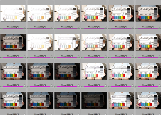

    3. As reference, this topside series shot on the camera table is what it looks like shooting normal brackets on manual.

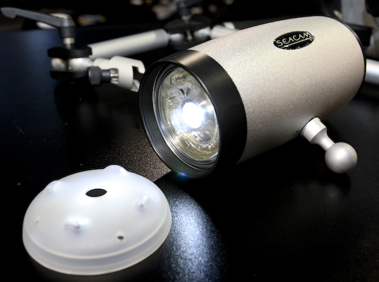

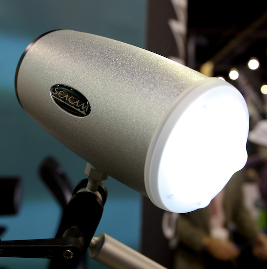

    BTW ... we wanted a diffuser to both widen and soften the light, and also add a little neutral density when working very close with a light colored subject. Harald Hordosch delivered the diffuser at the DEMA show, but I haven't had a chance to try it out in the water yet. Very eager to test that as well.
    Photos courtesy Matt Segal from the show:

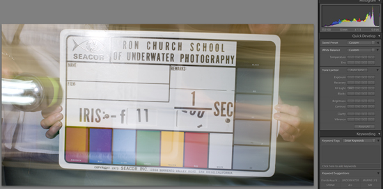

    Thanks Alex. I assumed rear curtain synch would probably work with the Seacam Seaflash 150. The logic being if they cracked the E-TTL code for exposure, the second part of the equation, rear curtain synch, would likely follow. Still, no substitute for the empirical testing and I forgot to try that in the water with by brief previous analysis. So:
    From my blog: "Canon shooters have long been challenged in the underwater realm when trying to achieve rear curtain synch. The issue is that only Canon topside E-TTL enabled strobes would work in rear curtain synch mode. Manual strobes, like we are used to using underwater, did not. That was an advantage that Nikon had over Canon when shooting ultra slow shutter speeds and trying to convey a sense of motion. With Nikon the trail of action would be behind, but with Canon (and forced front-curtain synch) the motion would be in front of the subject, and therefore visually confusing.
    Now, for the very first time, I have achieved rear-curtain synch with a submersible strobe, in E-TTL automation. See the topside simulation here taken with a Seacam Seaflash 150, shutter speed 0.6 of a second and F-11. The light and the exposure slate moved from my left to my right as I panned directly with their motion. Look at the trail of light as it falls BEHIND the flashlight!"

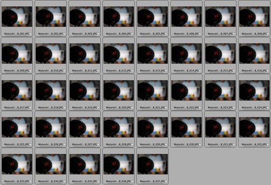

    Also tested was recycle time when using motordrive sequencing, very rapid btw. 37 shots in a row, each using exactly 4% of the strobe power (according to the strobe's rear LED). Aperture F-2.8 in this test. Obviously smaller apertures will dump more light, and a point at which the strobe will not keep up with motordrive will inevitably occur.

    I quoted Harald Hordosch on recycle time: "Harald Hordosch of Seacam wrote to advise me that the normal expectation is 2 - 2.5 seconds after even a full dump." On this test I wanted to be sure about recycle time, so I took the manual brackets shot at full power and checked the EXIF data on the camera to determine the time code for sequential shots. All were under 1 second for recycle from a full dump. That was indeed surprising, and encouraging, to me. Apparently, Harald's stated recycle projections are conservative and I found it to be much quicker in this test series done under controlled conditions. We couldn't really shoot faster than about a half a second, because it took that long for me to move the aperture on the camera and for my assistant to rotate the dial on the exposure chart, but we could never do what we needed to do with the camera adjustments to shoot faster than the strobe recycled at half power and less.

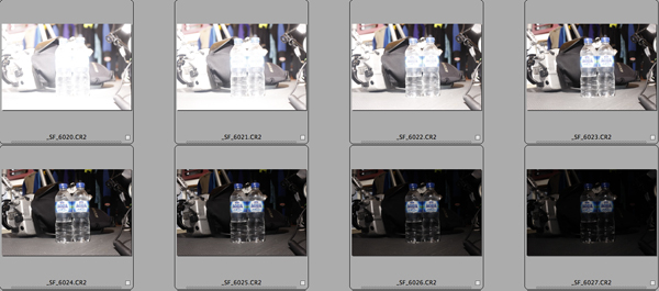

    test for manual power settings at Full, half, quarter, and one-eighth.
