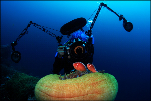

  7. Hi,
    We are talking about G9 not d-slr, right ? I do not think there is room to put any foam
    and I will not try to play with any thing on the little Patima port as it might cause the leak.
    This recent picture with dslr shows how Patima BC bag works. She is shooting Nexus d300
    housing + 2 Z240 in one hand & it hangs in the middle of setup & does not interfare with
    your shooting. It collaps but maintain buoyance like your BC does.
    Your Patima dealer should have more info but, PM me if you want to try it before buy.
