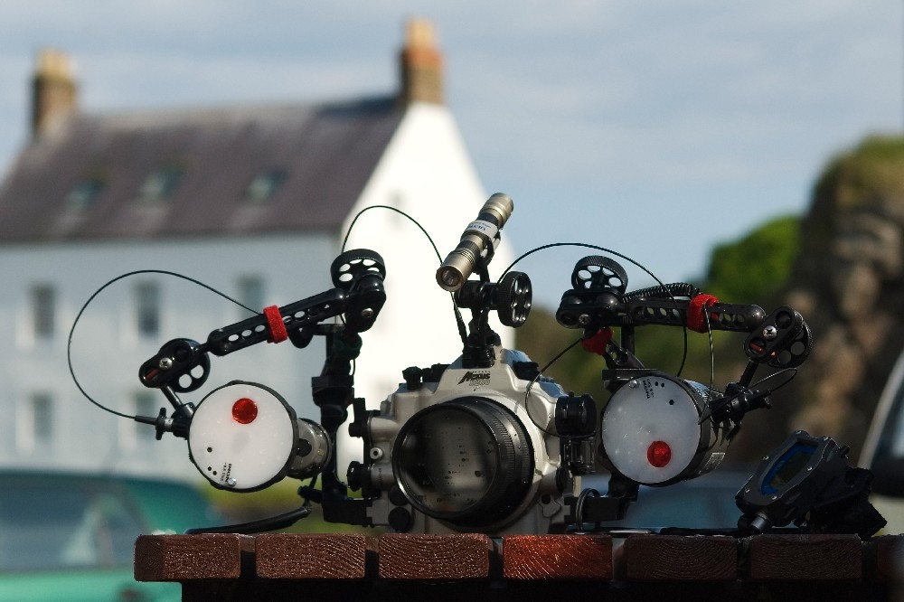

    I prefer fibre-optic connection, but do use a housing and strobes that are specifically designed for this function.
    Nexus, D200, Inon Z240 strobes, dual fibre-optic connectors.
