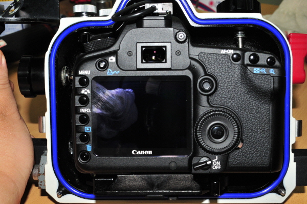

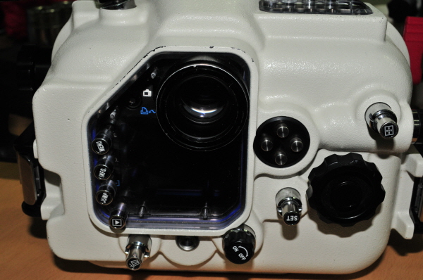

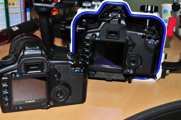

    My friend brought me his new camera & S&S 5d housing today to try.
    Some people thought it will be a easy one or hoped to just to fit and
    I have an answer here.
    1.It is not 'just fit'. You have to modify.
    2.Even to put the camera, we had to turn base plate off little bit on Lathe machine.
    Pls, do not try to do this with hand grinder. Camera is now in & in-line with control.
    3.On back cover, all left side buttons are not in line but, I think it is possible to make
    to reach like I did on Nexus d200 housing and/or you can do same thing by using
    little jog dial. S&S put 4 little buttons to do this & 2 buttons work without mod, which
    means you can change ISO & several other function with these 2 buttons.
    4.On/Off not working ( not a big deal).
    5. S&S did not put 'live view'button on 5d housing & is now needed for live view + movie. I think
    I can make a button but, hesitate to drill new hole, even on back window.
    I am going to help my friend but, am NOT going to produce mod kit for this housing.
    Sam
    5d & 5dMk2 side by side and 5dMk2 in 5d housing after little turn off.

    Does the viewfinder line up? It looks like it from the photo. How about the lens in the port opening? Is it centered or near center?
    Regards,
    James
  4. Thanks for posting this info Sam.
    Regards,
    James
    James,
    Yes, View finder lined up & Lens is in center.
    Sam
