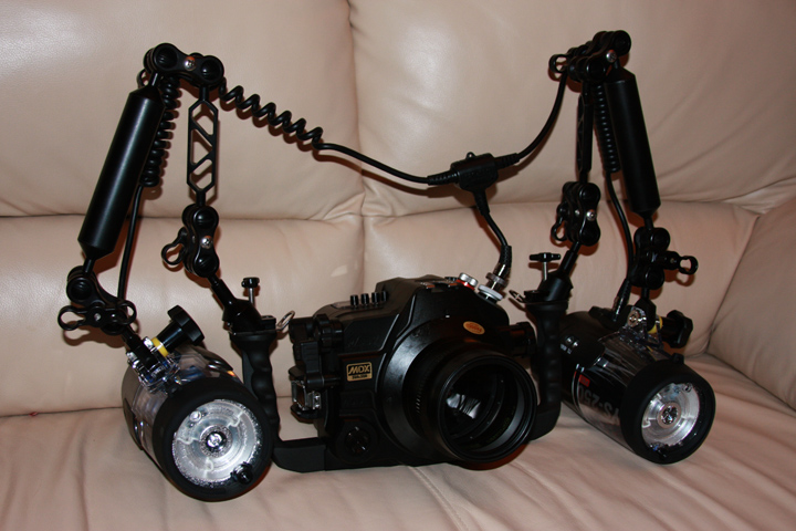

  1. Hi Guys,
    I just got my tray and arms set from http://www.i-divesite.com/. It took less than 4 days to get it all the way from Hong Kong.
    Anyway. I ordered a 5" and a 7" arm. There is also the sea&sea connector.
    It's kind of like this, but with an extra 5" arm and a clamp.
    Should I use the longer arm next to the tray handle or next to the strobe?
  2. I like the short arm next to the handle. At least with my strobes, it allows the strobes to fold in next to the housing and take up the minimum deck space. Whatever works.

  3. At the risk of triggering another arm's length controversy, why not leave the short arm off? I have cut down on weight by taking fewer arm segments on flights, and by using the "edge light" technique (described, believe it or not, by Martin Edge) get as little (or as much!) backscatter as I used to get with long arms. As some wetpixies know, I scatter my opinion on strobe arms at odd angles.
    There is an image of my macro setup on the "hotshoe" thread below; my wide-angle setup uses two Ultralight 8" flotation arms instead.

  4. Long arm near the handles. I like the short arms near the strobe for finessing the final position.
    Three responses. Three opinions.
  5. Three responses. Three opinions.
    LOL! and they are all three "right" for the reasons shown. That's why they make them in sections I guess.
    Steve
