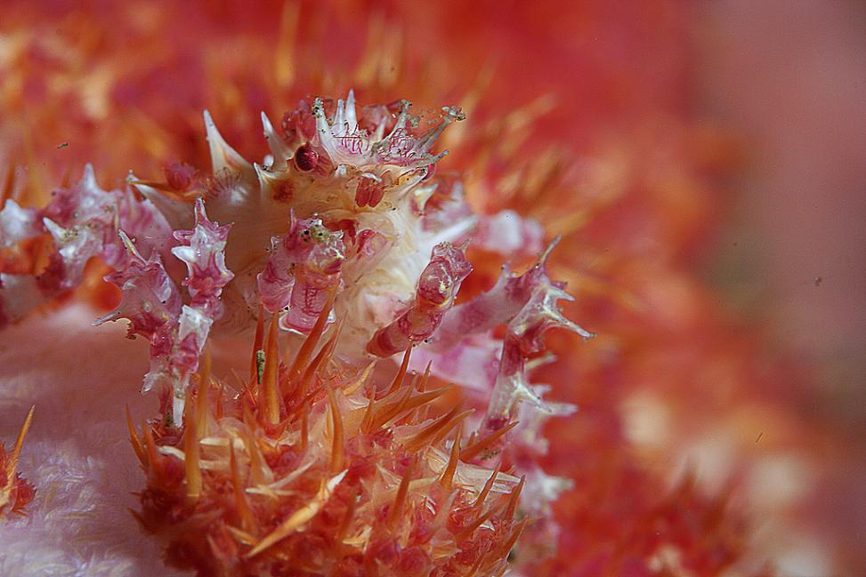

  7. If you want to shoot at greater than 1:1, you'll need a longer lens - like a 100mm with a teleconvertor and diopter, or the Sigma 150mm. The 60mm is an awesome starter lens for underwater and is very versatile, but it's not going to get you shooting bumblebee shrimp. I'm also not aware of any teleconvertors for the Canon EF-s lenses, so you'll have to get a longer lens.
    The shot below was taken with the 60mm and a woody diopter ( wet lens ), no cropping.

  9. The shot below was taken with the 60mm and a woody diopter ( wet lens ), no cropping.
    Stew,
    Wow.... nice shot! Decorator crab..where was the pic taken?
    I guess Woody's diopter would be another option.

  11. Stew,
    T
    The shot was taken at Lembeh. I would say get a wet lens anyway.
