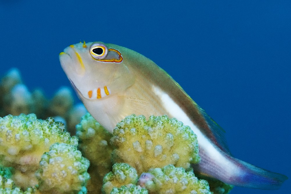

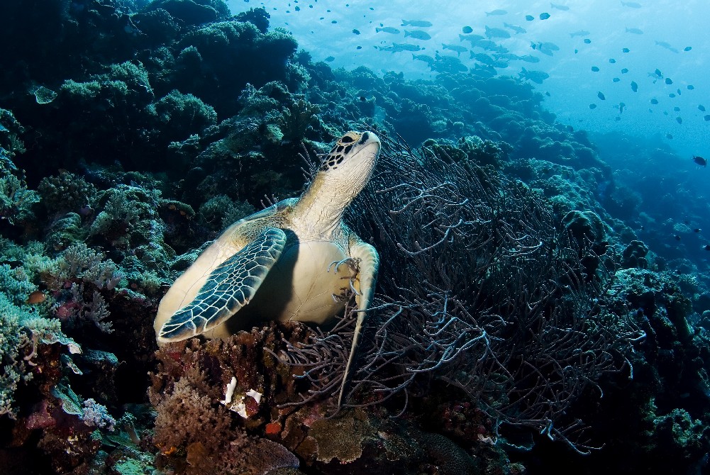

    Because a DSLR rig is that much bigger and optically quite different to a compact you have to relearn some parts of your photography. You have to get really close with a 10.5mm fisheye, and it needs much better illumination than a compact, for instance. The 105mm needs, in my experience, a good focus light if you use autofocus and, again, good (strobe) illumination.
    About 1m from the turtle, 10.5mm:
    105mm, about 60cm distance, reproduction ratio about 2.5:1:
    These comments, about getting closer and having better illumination, apply to most lenses, certainly to all wide-angles where the field of view is greater than a compact, and macro lenses where the f-stop is much higher than it would be with a compact.
