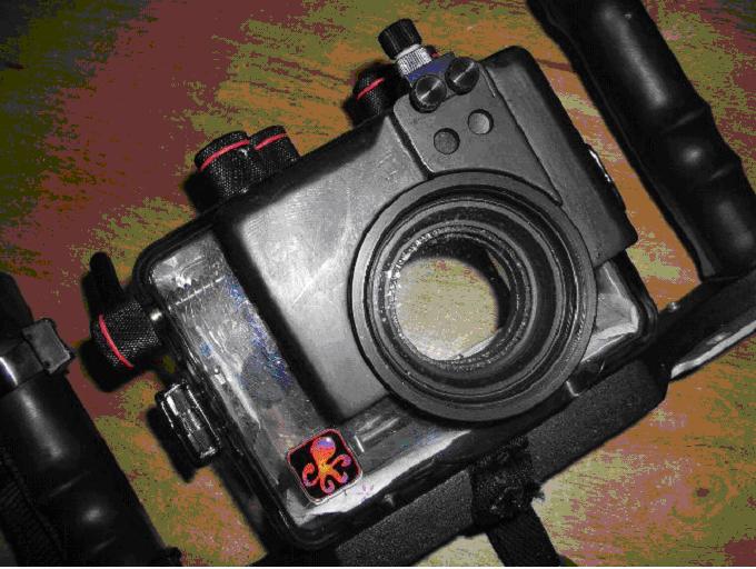

    Hi ... I don't know what the "official" INON solution is ... but Sea & Sea makes a velcro-based mask that has a nice pass through port for a FO dongle ... the part number is Sea & Sea Strobe Mask Set #SS-50109.
    Here's what it looks likes on the G9 housing

    thanks for the response, ive seen the Sea&sea mask set used before but wasnt sure how effective it was. I will look to investigate that although I was hoping for something a little less intrusive on the housing - I used to have an AD mount Base on my old setup and the optical cable attached to that so there was no sticky attachments to the housing. I was wondering if anyone has modified their diffuser for the housing in any way to attach the optical cable?
