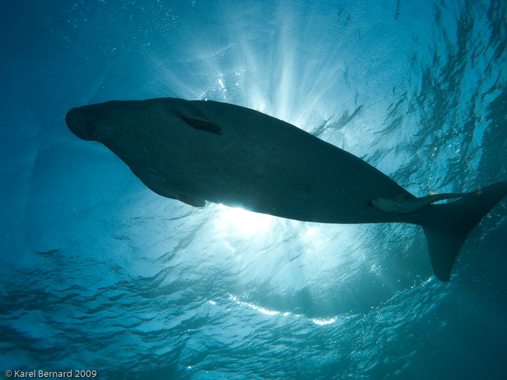

  9. I got my first sunburst shot last week.
    But I preferred to hide it behind the dugong I was photographing.
    I have not been able to get a decant shot with G9, where the sun is visible in the pic,... :-(
    Edit: Canon G9, 1/500 sec @ f / 8, ISO 100
    p.s. Rand, Your shot is outstanding!! What setting did You use?!

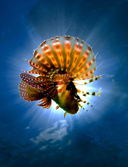

    Here's one that pleased me, taken mid afternoon with a D200 twin Z240's 10.5 FE, f10, 1/250, ISO 100.
    I was about 3m deep and the lion fish was about 8" from my domeport.
    Surface was flat and there were a few whispy white clouds in the sky.
    Other shots didn't have the fish directly infront of the sun and were binned.
