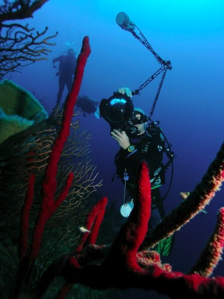

  7. I always use two arm segments/side regardless of whether I am shooting macro or WA and have the Ikelite dual sync cord. I just wrap the cord around the clamps (ULCS) as needed, and it stays in place just fine. Below is a pic of my WA setup. The splice is normally not in the way in WA, but sometimes needs to tucked away in macro. I also have a focus light for my macro setup that I usually wrap the slack cord around.

  9. I always use two arm segments/side regardless of whether I am shooting macro or WA and have the Ikelite dual sync cord. I just wrap the cord around the clamps (ULCS) as needed, and it stays in place just fine. Below is a pic of my WA setup. The splice is normally not in the way in WA, but sometimes needs to tucked away in macro. I also have a focus light for my macro setup that I usually wrap the slack cord around.
    Are you using any extension cords in that image?
  10. No. just the standard dual sync cord. Even with my arms straight out its long enough. The arms are a ULCS 8" (inner) & 12" (outer) on each side. I normally stretch the cord a little before looping it around the clamp for the outer segment, and then just let the inner part free float. Sometimes I'll hook the splice on the clamp at the my left handle if its getting in the way.
