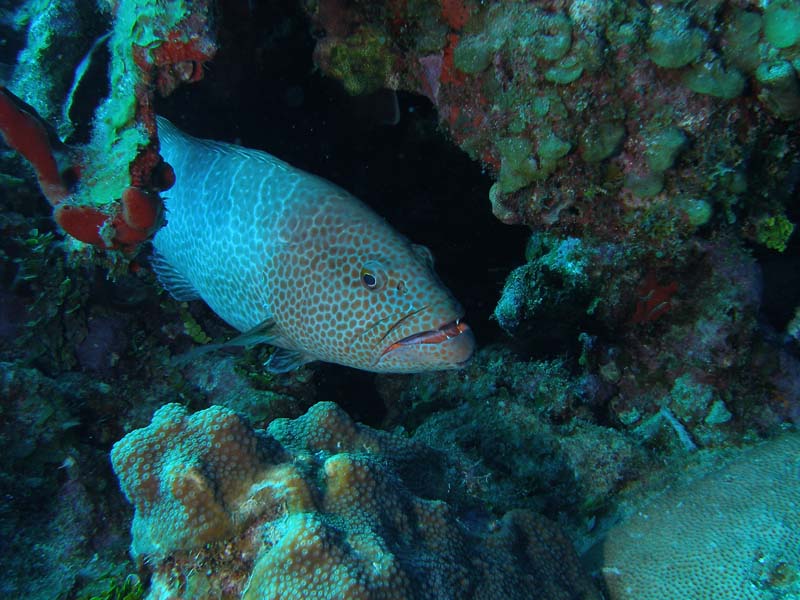

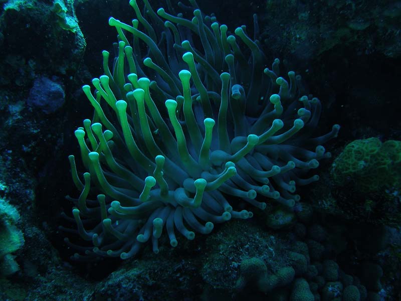

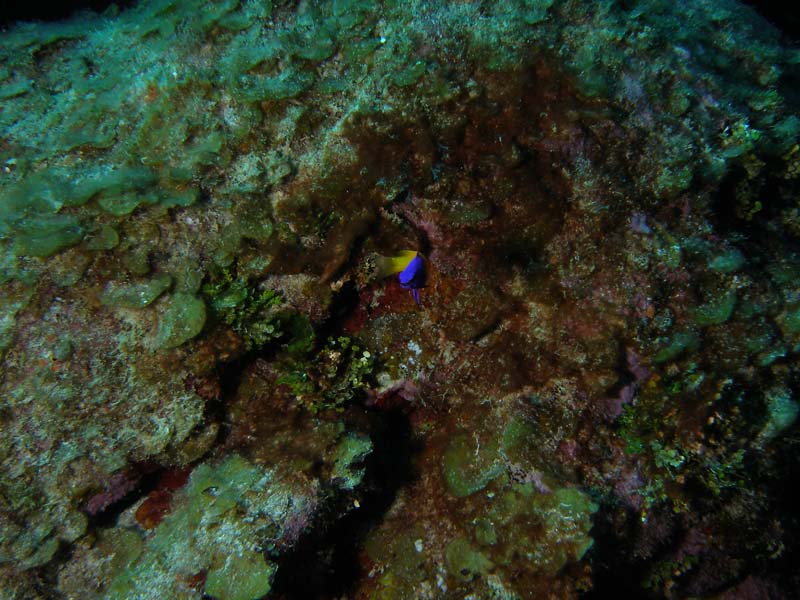

  5. Here are some examples of pictures taken while in S-TTL and My Mode on the camera. The speed and f stop's varied, but should have been pretty close to ideal, and I think it's apparent that the strobe isn't firing enough regardless of the exact settings on the camera. These were all close shots. The royal gramma was in macro mode and about a foot away. The anemone was also in macro and about 6 inches away. The grouper was in normal mode and about a foot and a half away. Also I should mention that later in the dive I went back to what I was used to. I put the strobe in Auto and the pictures turned out fine. So there is definitely something with the S-TTL and not the strobe or camera. I just don't know if I have it set up to work properly.
