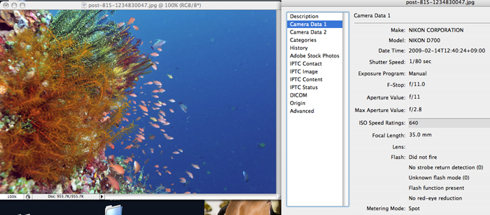

    Hi Sam - If you are happy with the image, that's all that matters. But, to clarify, your two posted images were at the 35mm end of the zoom range apparently, and at F-11:
    You would expect the corner smearing to be more pronounced at the 17mm end. Although, having said that, your over/under is at the 17mm end and it looks good in the corners.
    It will be interesting to see more real-life testing as you have time with that lens and port combo. Thanks for sharing.
