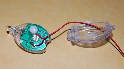

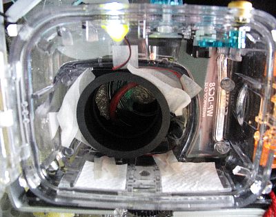

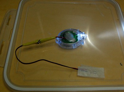

  8. 1USD mini Leak Detector :D
    Hi,
    yesterday I found the mini flash light at the 100yen shop.
    I thought it was suitable for the leak detector. So I purchased it
    and made the leak detector.
    I only disassembled it and soldered the sensor lead to it.
    Its size is the same as the coin battery case.
    I set the detector to the Canon G10 housing.
    While it cost 1 USD (correctly saying 1.1 USD), it is smaller, brighter
    and easier to set up than my 3 USD leak detector.
    Details is here. (written in japanese & English)
    Thank you.
    http://hanachan.ddo.jp/

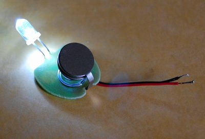

  9. Hi, good news!
    Today I have found the same mini flashlight I used on DX.
    This Item
    Price is $2.8 (2-packs, Free shipping).
    So I must change the title "1.4USD mini LeakDetector".
    Let's try DIY!
  10. Hi,
    I have been asked why my cheap detector does not work in fresh water.
    My answer is that fresh water has little ion ie high resistance. so the
    electric current is very little(near 0) between the sensor electrode in fresh water.
    As a result the detector failes to emit light.
    I would like to show a solution that my detector can work in fresh water.
    This light is very cheap but very intelligent. It works all or none mode.
    When the electric current between the sensor electrodes exceeds some level,
    it emitts.
    The level to emit light is already fixed. We cannot change the level.
    So it is necessary to increase the electric current between the sensor electrodes.

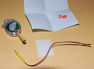

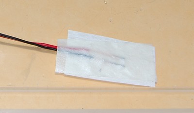

    experiment:
    I made the 2nd detector. It was very easy and I finished DIY about 10 minutes.
    I prepared the salt and the paper.
    I sprinkled the salt a bit over the sensor electordes on the paper
    and covered it with adhesive tape.
    The cheap detector was sucessfully emitted with the fresh water !
    Of course, Under the Sea, NO salt is necessary.
    Thank you.

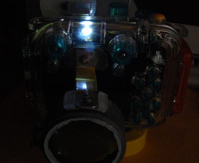

  11. Hi,
    Yesterday I have dove at the Sado Island. At the ferryboat returning home when I opened
    the tarvelling bag to take the waterproof case of G10, I found my cheap leak detector emitting light.
    I was very surprised because there was no sign of water invasion in my diving course.
    I opened the waterproof case and the right paper at the bottom of case seemed very little wet.
    And a very small water drop (less than 1mm) attached at the bottom of G10.
    I'm not sure when and where the water invaded. at water pool to remove the salt after diving?
    I knew this cheap leak detector works well with very small amount of water invasion. :lol:
    So I report.
    Thank you.
