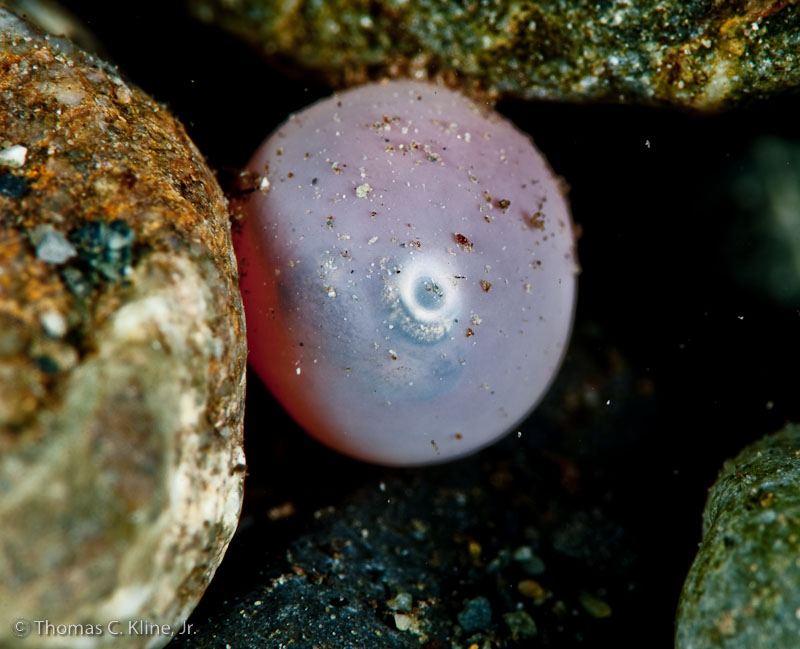

  3. Stephen's blog covers some of my methods. I wear waders and not dive gear. It is generally too shallow to dive. I often have to hike in some distance as well so use the minimal gear. Rivers can be extremely dangerous - I stay where I can wade. I look for good visibility which leads me to smaller streams rather than rivers. I use both with (see blog) and without flash (see my post in 'favorite of 2008' thread). I shot some macro today using the 105VR with 5T diopter and two Z240 strobes, so anything goes. It all depends on what one is shooting. I was shooting salmon eggs today. See attachment. Water temp was 2C (I had a thermometer with me). I walked on ice covered stream to get to open water. My main lens has been the 14 prime with the DX format. I have yet to use digital FF, so you are ahead of me.
    I bought into Seacam because it was the only housing available at the time with both a remote control and interchangeable magnifying finders - I used the S180 today. I used the Nikonos RS prior to going digital, which had both a remote control and a very good finder. I did not want these factors compromised so went with Seacam. In fact, Seacam goes several steps further with both finders and remote possibilities compared to the RS. :aggressive:
