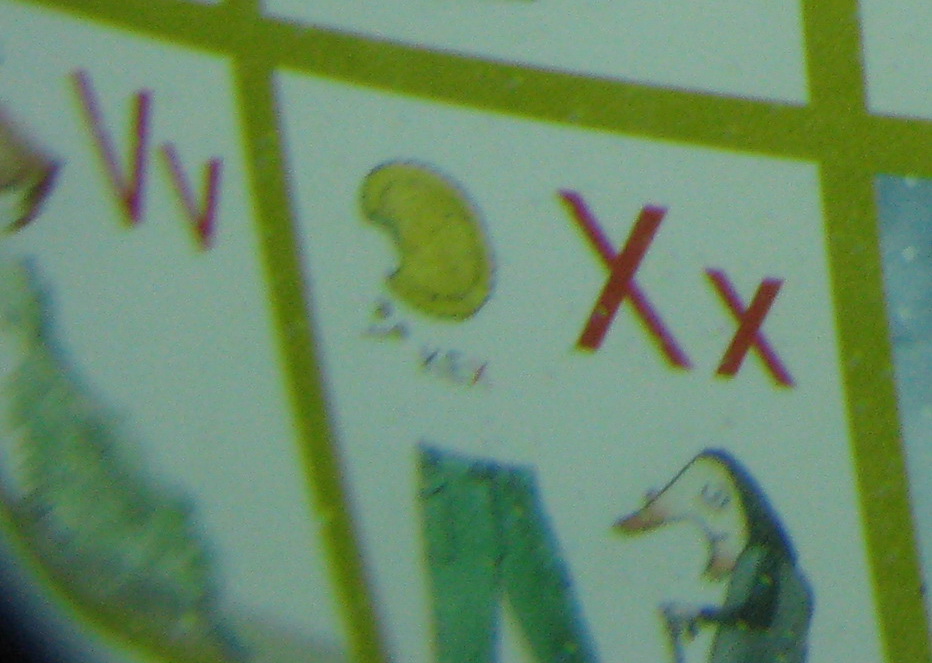

  1. After some time just reading this great forum I thought that I might contribute with something in the D.I.Y-area.
    I have an Ikelite housing for my Canon G9 and was interested in wider angle of view. After some research I decided on the Inon UWL-100 with the dome. I also got the short wide-port that Ikelite sells.
    When I got the lens I couldn’t wait to try it in the ocean so I decided to try it in the bath tub.
    I was very disappointed. There was very smooth corners and some minor vinjetting.
    I decided to fix the problem. The solution was a new homemade port for my lens and housing.
    Here are some photos showing before:
    The port and the attached to the port:
    Picture after the modification:
    You could visit my website for some more info.
    /Martin

    It is the same angle of view. The distance from the object might be a little different. The soft corners will be there regardless of the distance of the object.
    No, it's not a 100% comparison but the conclusion is the same.
    I have many testpictures and I choosed one of them.
    i think
    without the modification, narrower aperture (incresing F number) may make the coner of pict sharp
    and slightly zooming up may cansel the vignetting. (Or the cropping the upper pict ..)
    Yes, it will get sharper with increasing F-number but I want to show the worst case senario and that you will get a nice picture even if you need a large apature. Taking WA-pictures here in Sweden with a G9 requires a large apature. The "After" image is also taken using f/2.8
    Yes, vingetting will disappear if zooming but zooming slightly on the G9 will move the lens away from the WA-lens, giving you an even worse corner sharpness. You will also loose some of the nice wide FOV.
    Attached image shows crop taken with f/8. You will loose almost 3 stops compared to f/2.8 and that is much here in Sweden with poor visibility.
    /Martin
