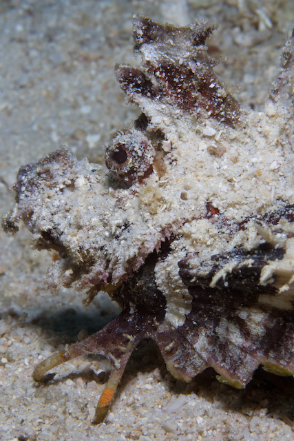

    Alex,
    here is one of them that I shot last week end. I might be difficult but I'd like to have it sharper :bye:
    Settings:
    - f stop = 18
    - shutter speed = 1/100
    - Iso = 100
    this picture was taken at around midday on a cloudless day at around 5 meters.

  6. What is your workflow? Are you shooting RAW or JPEG? If RAW, what is your sharpening routine in post-production?
    Here's a pretty good article on sharpening .... http://www.ronbigelow.com/articles/sharpen1/sharpen1.htm
    Here's your pic with a bit of very quick sharpening work in PS using the unsharp mask (it would work much better on a full-sized uncompressed image and with some care):

    If you want absolute sharpness, you're going to have to open up the aperture a bit. :vava:

  9. What is your workflow? Are you shooting RAW or JPEG? If RAW, what is your sharpening routine in post-production?
    Problem solved uh? The sharpness seemed to be there all the time...

  12. You can do a lot with proper sharpening. You do want to start with the sharpest image you can shoot; sorry capture.
    You lens is probably diffraction limited at f18. Though you lose a little depth of field you will probably find you lens is sharper at f16 max.
