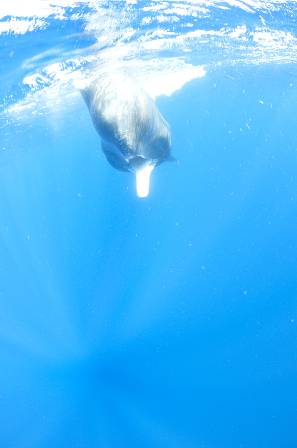

    UW, my sperm whale pictures, available light.
    surface some bird shots (bright sun with rocks).
    nikon found a problem claimed to have fixed it, not fixed. using firmware 1.10

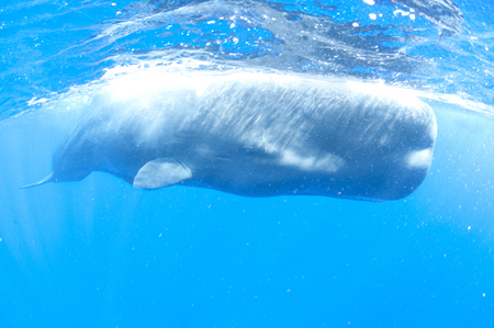

  4. was using matrix metering 320 iso, a priority.
  5. another shot, matrix metering, A priority iso 320.
    using the 10-17 tokina, behind the 9.25" aquatica dome. Unt touched RAW, just converted to JPEG
  6. Most cameras will need at least -1 stop exposure comp when shooting down into deep water. Are the rocks in the rocks 'n' birds pics dark toned?
  7. These look very underexposed to me.
    Darren is spot on that cameras are programed to work on land - so when faced with a lot of blue your camera will try and expose it as if it were the sky. In other words a light blue.
    To get a rich ocean blue you have to under expose. So people usually dial in under exposure of about 1 stop or more. All the available light, large animal photos you see are taken with at least this level of underexposure.
    So I doubt there is a camera problem - subject matter like this just requires some exposure compensation.
    To be certain - take a land photo in normal lighting of a normal subject - and see if the exposure is OK. And underwater image like this won't tell you if it is a camera problem.
    Getting back to the whales, I'd guestimate an exposure of around F11 @ 1/90th on ISO 200 for this type of situation, so I am not surprised that the camera's selection of F8 @ 1/50th ISO 320 is over exposed. But this might just be a consequence of the camera's metering not liking the deep blue underwater world.

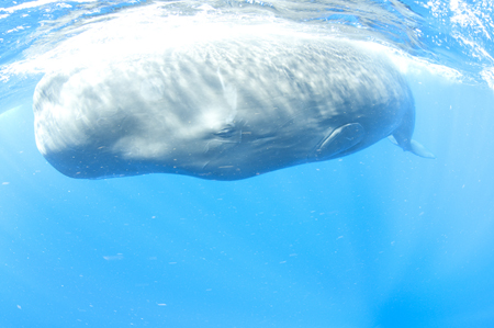

  8. another shot, matrix metering, A priority iso 320.
    I use the same setup but I _always_ expose manually (I do use TTL though) UW.
    On land I often use automatic metering though. I find the D300 to be very good at exposing. Sometimes it's better to use Spot than Matrix though. For instance if you take a picture of a person and the face of the person should have the highest priority.
    But, back to UW shooting. First of all, when shooting close to the surface on a sunny day, never raise the ISO. Leave it at 200. Then go for a fast shutter speed (if you are using strobes, 1/250 is the fastest you can pick) to get nice sun rays. Finally, if you are shooting with strobes, then go for a very small shutter speed, as you will get over exposure otherwise. Well as long as the sun is in the picture, you will always get over exposure in the sun, the trick is to get as little as possible. Checking the histogram is of course very nice, but if you find it hard or don't have time for it, then at least use the Highlights display mode (where over exposure parts "flickers").
    If you are able to take numerous shots, start with an f-stop at e.g. 11. If you don't get any "highlights" flickering, open up the aperture. If there is tons of flickering in other parts than the sun ball, go for a smaller aperture. etc. I'm sure you fully understand this, but perhaps someone else is reading as well. ;-)
    Hope this is of some help for someone reading this!
    /Peter Segerdahl
