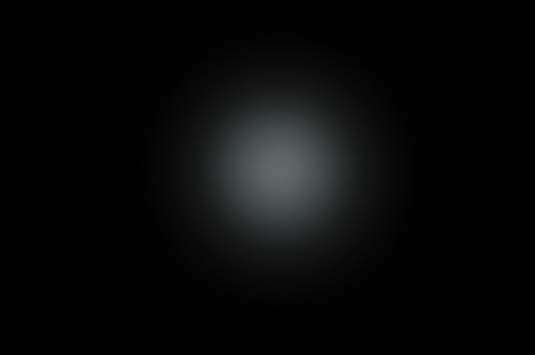

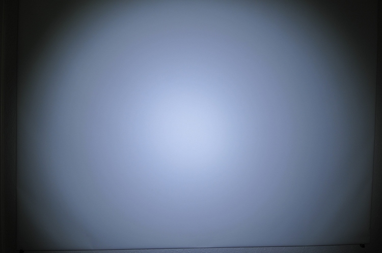

    To show how great it is, I did some tests in my basement.
    For all shots: D-SLR on a tripod, manual settings (f9, 14mm on a DX lens, ISO 200, 1/10, manual WB). The wall the lights are projected on is a 100" 4:3 projector screen.
    FIXLED1000 at maximum power.
    Ikelite Mini C Halogen with Fisheye Diffusor.
    LED Lenser Frogman (the "big" one) with simple home build diffusor.
    Tauchen Lamp GS35 with Diffusor head.
