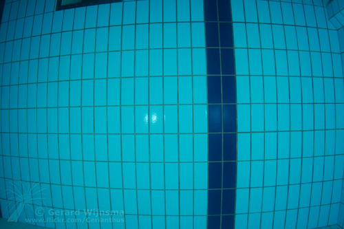

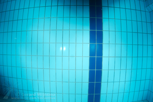

  6. I have two DS-51 and use them on a 15mm FE lens (cropped). On the green water forum digigreen there is one that uses them with the 10-17mm FE from tokina.
    I did some pool tests (with the 15mm on a canon 20D) to see if I really needed larger coverage. Without diffusors, you get dark corners : depending on your subject it is usable but you need to be carefull.
    With diffusors, it lights the entire frame easily (it is darker in the corners, but that has more distance as well.
    Without diffusor
    diffusors on both strobes..

    Thanks for the with and without diffusers comparison - it illustrates both the coverage and brightness hits.
