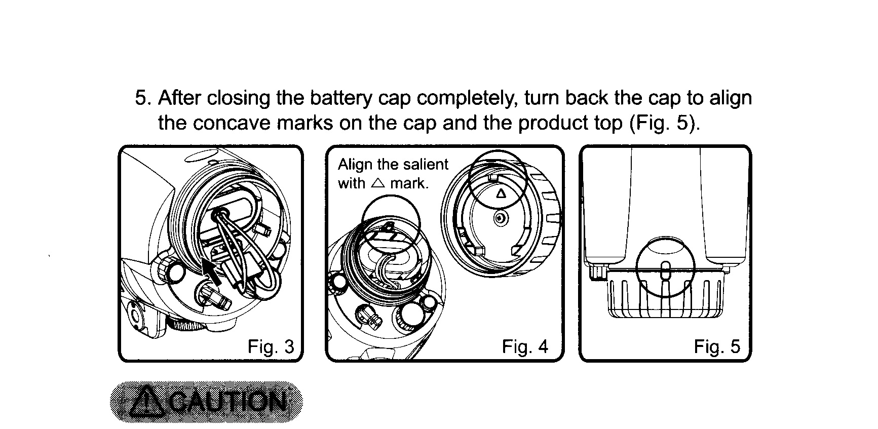

  2. Sorry to hear that Allison, I"m curious, do you know if the cover was over tightened? Did you roll the cover back after tightening it so the semicircle on the cover lined up? I'm guessing it can get overpressured if you don't.

    Hope they get it fixed up for you. I was refering to the alignment marks on the top of the battery cover. It's noted in the manual on page 10 (english version) With mine it's very easy to over crank the cover and then I usually have to turn it back so the marks line up. It's an easy thing to forget until you get in the habit. Seems counter intuitive not to tighten the heck out of the thing but that's what it says.
    The manual doesn't say why we're supposed to do this or what happens if you don't, so I could be all wet. You may have just gotten a bad part. Glad they are going to get you fixed up.

  5. Hope they get it fixed up for you. I was refering to the alignment marks on the top of the battery cover. It's noted in the manual on page 10 (english version) With mine it's very easy to over crank the cover and then I usually have to turn it back so the marks line up. It's an easy thing to forget until you get in the habit. Seems counter intuitive not to tighten the heck out of the thing but that's what it says.
    Have fun,
    Steve

    Steve - as you can tell by the way I craftily ignored your question, I have, indeed, been overtightening my strobe covers!!! I went back and looked at the book, then promptly loosened the one that I have here. That said, the crack was on the side of the cover, not anywhere near the valve - seemed like a stress thing from torque more than anything, but given the limited # of times I've even touched it, I was a bit taken aback.
