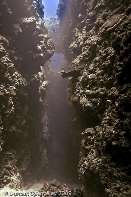

  1. We have been playing around recently in Sharm as it has been fairly slow on the tourist front. What we are trying to do is get some half decent shots of some popular (and not so well dived) technical dive sites. We have been playing around with tri pods and long exposures to try and squeeze out some detail using natural light. The image below is looking down Thomas Canyon at Tiran. The tripod was set up at 48m, the top of the arch is around 38m, the blue area below the arch is around 50m and the bottom of the shadows is at 68m. We took a series of shots and bracketed the at +2 and -2 on AEB as the tripod was not steady enough (modification in progress) The shots were iso200 and f11. Ideally we want to close down the f-stop once the tripod is more stable. We then tried an HDR conversion. This is all quite rough as I have never tried HDR on land let alone underwater. The plan is to try and get round to The Lara at the back of Jackson and try a similar thing.
    Does anyone have any experience / input that could help us out?
    Couple of questions;
    Magic filter - I understand they are designed to work down to 25ish m. Is there any (however small) benefit of using one at this depth.
    Can you stack the filter(ie 2 layers) to double the strength?
    Any other advice,comments gratefully received.....
    Duncan

    Settings were as follows. iso 200, f11, 0.8s, 1/5s, 3.2s
    The tripod itself was rock solid, it was the connection to the housing that was not the best. There is a nice sandy slope with a big rock which was perfect to rest the tripod on. Then off came the ankle weights and they were hung on the back legs. I also had 2x ds125 strobes to keep the housing a bit negative. To connect the housing we cable tied a 10bar slot stay tray off a compact to the tripod head and then at depth cable tied the housing to the slot stay. This was a bit wobbly!!!!! Cable ties are tricky buggers with a tinge of narcosis (tri mix too expensive for a lowly instructor!!!) The plan is to drill a hole through the tray on the housing and attach the tripod mount with a suitable bolt!! Tripod is nothing fancy and had it clipped to a stage for transport. The guests on the boat thought we were nutters!!!
    Once we get it a bit more solid I was hoping to be able to fire off more than 3 shots for a better conversion.

  11. Just a point on HDR. I do a fair amount, and have shown some UW HDR on this forum. I use Photomatrix. Having said that, I'm not sure I see any benefit for you using multiple image HDR on this project. In my mind the main advantage of multiple image HDR is when having to deal with extremely high dynamic range subjects, such as sunballs with deep shadow under water that exceed the capability of your sensor. On your histogram this would show as a highlight spike on the right with shadow information all the way to the left - highly unlikely at depth. At this depth, dealing with high dynamic range subjects should not be the issue. If the dynamic range of your subject does not exceed the range of your sensor as shown on your histogram, there is no real advantage to capturing multiple images for HDR. Using HDR with multiple exposures at slow shutter speeds also increases your chances of motion artifact which degrades the image topside, and even more noticeably underwater. Even with a rock solid tripod, any water movement that moves light rays, fish movement etc, will degrade the image. HDR processing in general will also tend to increase noise problems if they exist, in the image rather than decrease them.
    Long exposure noise problems are not characteristic of the shutter speeds you are using with most modern cameras. In my opinion your best results will be with the highest ISO your camera can utilize without significant noise degradation, obviously camera dependent. (Possibly 400 on a D200 type camera or say 800-1600 on my D700) Then use a larger aperture than f11 that you describe and shorter shutter speed, I would prefer a wider lens aperture as sharp corners are again not likely to be a major concern for the type of subject matter you show. Use your histogram and expose as far to the right as possible.
    Then you can worry about dealing with any noise in post processing, and if you want an HDR effect do single image HDR technique in post processing.
    I think this approach will get you the best possible image quality at capture, which you can then manipulate to best advantage in post.
