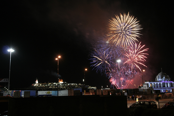

    It certainly does take practice. I have had one attempt at it which was when the QE2 sailed out of Southampton docks for her last time. Not a great shot, but was great fun trying to get it right ( even if I didnt )
    One tip I would add is to try and get up wind of them as if there are too many fireworks there could be a lot of smoke. Unless of course you want the smokey effect in your shot.
    Stew

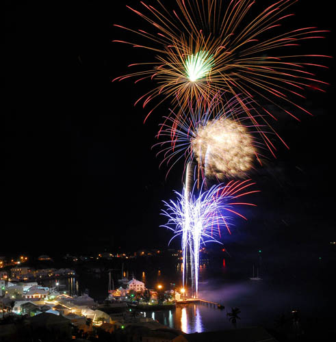

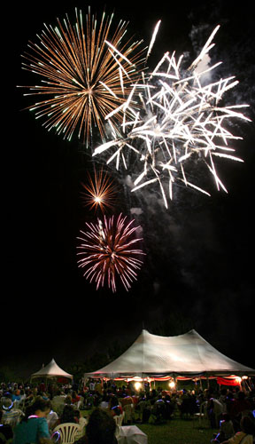

  4. well i have a few mins now, the weather's picked up suddenly and we've swapped from diving to wakeboarding.... so i got time to post the only 2 fireworks shots i can find right now:
    8.2secs at f/11 iso200
    .6secs (hmm?? seems too short) at f/8 iso640, must've been the finale, why only .6secs shutter, the foreground was fairly dark and had to dodge it out a bit
    as you can see, exposures vary a lot depending on the situation so you have to judge it from the lcd as you go. cheers,
    chris
