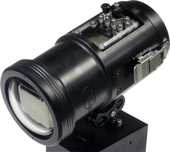

  1. I just got new Patima SB-900 housing & testing it this week. Nikon is replacing SB-800
    with more powerfull SB-900 & it requires new housing. I have been using this
    tube type strobe housing for over 5 years & I was happy with correct TTL I was getting.
    My SB-800 strobe housing was made by Subal & UwP49 shows new Subal SB-900 housing
    & also,looks very good.
    Here is picture of Patima housing;
    Size: 220mm x 110mm
    Weight:1300g, Positive in UW.
    Material: Acetal plastic in middle & Aluminum in both end + plastic dome.
    Controls: All except remote cntrl.
    Sam
