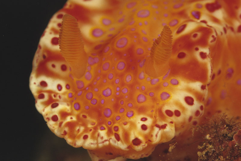

  5. While I have yet to try to house this combo to use underwater, here is a photo taken with my "land" macro setup. (I put land in quotes because the subject is still underwater...)
    Canon 5D
    Sigma 150mm macro
    Kenko 1.4x TC
    Canon 500D
    This results in 1.9x magnification
    Here is a 100% crop: (the scale bar is in mm)
    Edited by acroporas

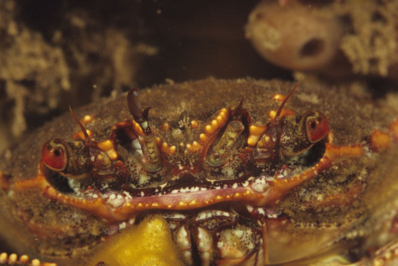

  13. I would disagree with Acroporas when he says the due to the way they work, extension tubes would not work well with the Sigma 150 macro lens. I did a small bit of shooting with the Sigma 150 plus extension tubes during a recent trip to South Australia. The Sigma 150 plus 56mm (a 36mm tube + a 20mm tube) of Kenko tubes gives a magnification range of about .33x (when lens is at infinity) to 1.85x when lens is at minimum focus. With 2 36mm tubes (72mm total) the magnification range is about .44x ~ 2.1x. I shot a roll with each combination on my F5 and was quite pleased wih the results, especially at the closer distances and higher magnifications.
