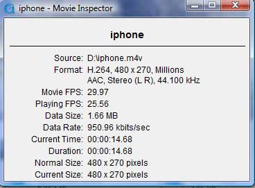

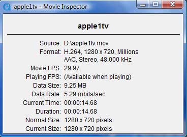

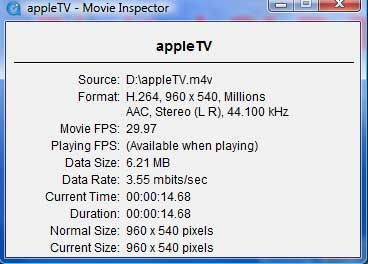

    1280/720 H.264
    iphone
    Apple TV size.

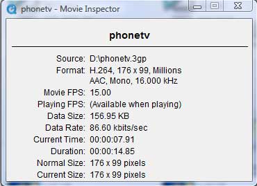

    Mobile Phone 3gp
