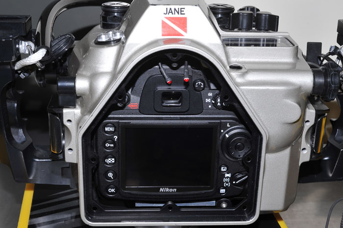

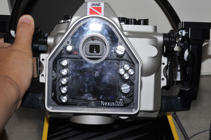

  1. I had a chance to play with D300S today. Pictures in announcement shows it is same size as D300 but,
    I wanted to try with my housing & was pleased to find it is same size camera with 2 additional buttons.
    I am going to make new back window for d300s camera soon.
    I also, felt it has very fast auto focus & like 2 card slot so that I can save jpg pictures on one
    card & RAW files on the other.
    Sam

  3. Very nice...well for the Nexus owners:) I really do hope that the other housing brands will this time come to the party and provide modified backs for their existing D300 housings.
    It looks like the multi sector has moved to the right and that the four buttons does not properly line up, is that correct?
  4. Another tricky detail is that the center button of the multi-controller is required to activate video recording, so that assembly will have to be reconfigured to access the center button (unless you can press two buttons at one).
  5. Good information Jane - I mean Sam :-)
    Regards
    James
  6. Very nice...well for the Nexus owners:) I really do hope that the other housing brands will this time come to the party and provide modified backs for their existing D300 housings.
    Re location of multi dial, it has been that way since they produced d300 & I have a way to cover that in my mod.
    My original mod on d200 to take d300 was using existing back window but, d300s now requires new back window
    which is not a big deal.
    Sam

  13. Hi Sam,
    you said that you have modified a D200 housing to use a D300 in it.
    What are those modifications?
    I have a D200 in a Hugyfot housing and think about bying a D300 (or D300S).
    best regards
    Robert
  14. Hi Sam,
    best regards
    Robert
    It's not possible with Hugyfot, it's such a tight fit. Not like Nexxus with plenty of extra room inside – a downside with the compact size.
    /c
  15. It's not possible with Hugyfot, it's such a tight fit. Not like Nexxus with plenty of extra room inside – a downside with the compact size.
    /c
    Hi Christian,
    hmmm, not good. The D200 and the D300 look so similar.
    http://www.digitalreview.ca/content/Nikon-...LR-Camera.shtml
    So i have to by another D200 as backup.
    Thanks a lot
    robert
    Edited by rob1963
  16. Hi Christian,
    Thanks a lot
    robert
    Yes Rob, they are very similar in size. I tried and it was almost possible ... but the Hugyfot is a very compact housing. If you want something else than a D200, you could have a look at the Fuji S5 Pro. Only 6MP and very slow, but still unbeaten regarding dynamic range-tests in DXO and DP review. Haven't tried it myself, but I know of at least two guys here in Sweden using and raving about them. And their images do look fantastic.
