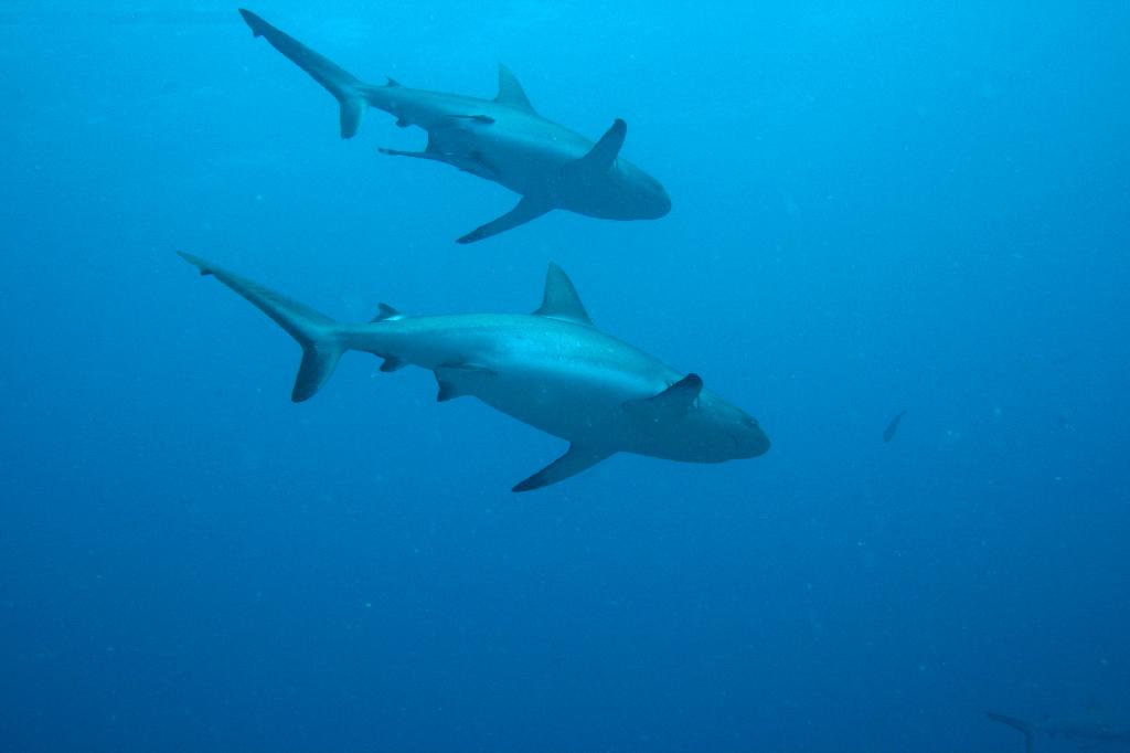

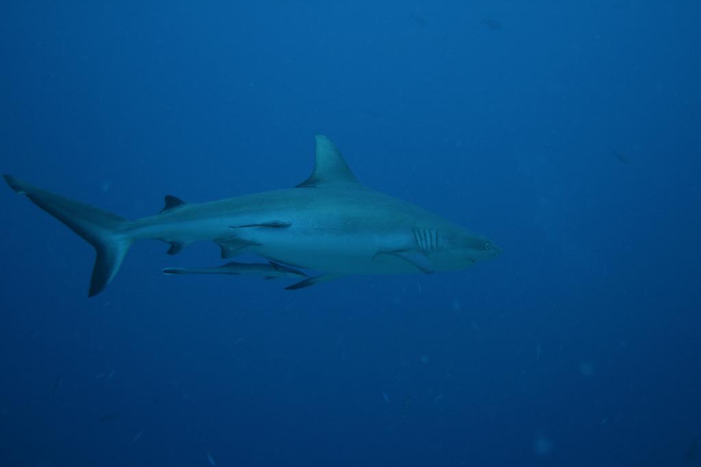

    sorry for the late reply I live in Indonesia we are 14 hours ahead of you which makes it difficult to reply as one of us are normally in bed asleep.
    I have attached two pics that look ok but when you adjust in photo shop you get allot of back scatter I now know to turn off strobes because the sharks where to faraway and I was only lighting up the water column which had allot of particles.

  6. I dont think there is too much wrong with your shots how they are. I have just had a play with the first one in PS and your strobes have as you said lit all of the suspended particles in the water column. Get your strobes behind your dome and facing outwards if you are going to use them. The 3 things that would improve future shots of this nature would be.
    1. Get closer - seriously, get closer then get closer.
    2. The 18-55 isnt the best of lenses and you will see a vast improvement in image quality with some better glass.
    3. If your camera is like mine then it will suffer from a lot of noise. But, try upping the ISO a tad to see what happens
    And of course as previously said, turn the strobes off unless the sharks are right in front of your dome port.
    Stew
    Edited by stewsmith
