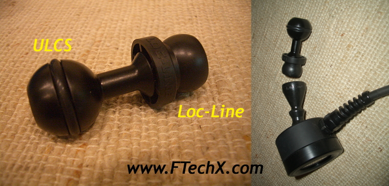

  1. One of my customers wanted an adapter to use his FTechX Classic 700 videolight (www.ftechx.com) with Ultralight Control Systems (ULCS) arms. I provided an adapter which might be useful to others with lights or attachments, which connect with Loc-Line arm systems, but would rather use Ultralight Control Systems arms.
    A picture of the adapter alone and the adapter "about to be connected" to the FTechX Classic 700 videolight is attached.
    The adapter components, in order of their assembly, are
    1) Stainless Steel Round Head 10-24 x 2" (cut to about 1 3/4")
    2) ULCS AD-MINI Adapter
    2) Loc-Line 51895 Fixed Mount for 1/2" System
    4) 10-24 x 9/32" Stainless Steel Tee-Nuts with Brad Hole, trimmed to fit the Loc-Line Fixed Mount
    Using the various available Loc-Line adapters this can be used with either 1/2" or 1/4" Loc-Line components. If you have any questions about this DIY drop me an email.
