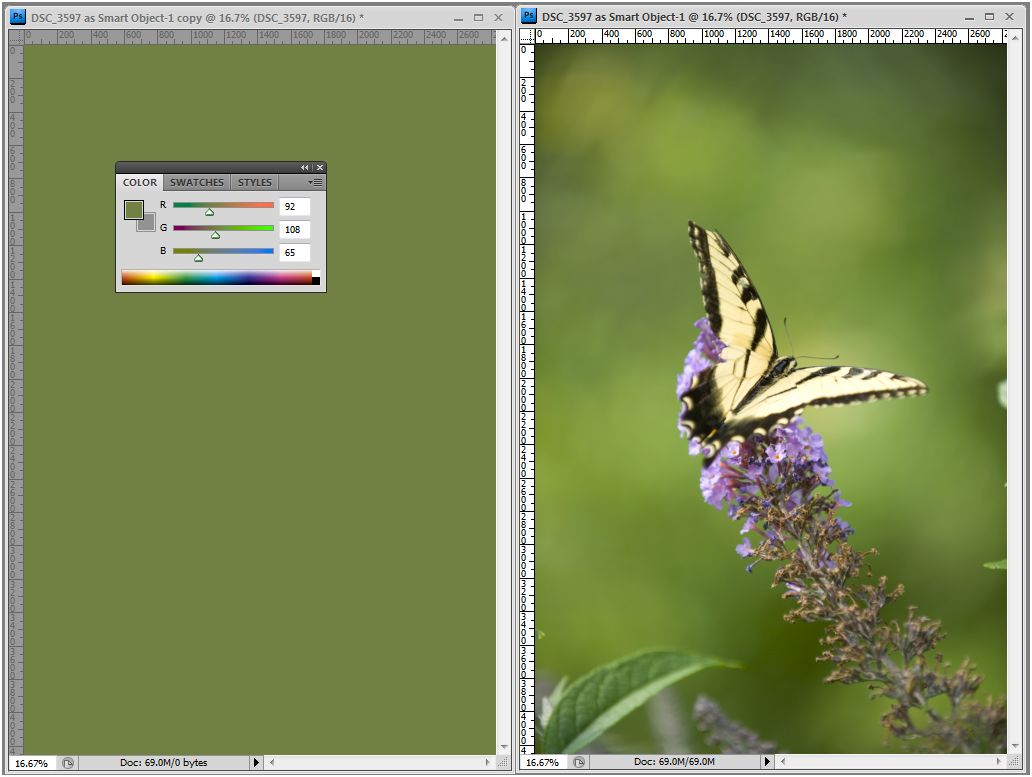

    Really? I think you may be selling AutoWB short a bit ... How else can we explain this in-camera 'auto' wb result?
    This is from a D700 shot with Auto WB and processed in ACR with no adjustment to the defaults. Then I made a copy and averaged the color.
  6. That's much better that I would have expected from Auto WB. Perhaps I am selling it short. I think I would still prefer to know that the colours are correct, consistent and repeatable.
    EDIT: OK, after playing with Auto White Balance with my D300 I am actually very impressed. I had used it with my D70 and found it to be worse than useless but I'm amazed how close the D300 gets it. In fact, it is so good I can't even understand how the camera does it.
