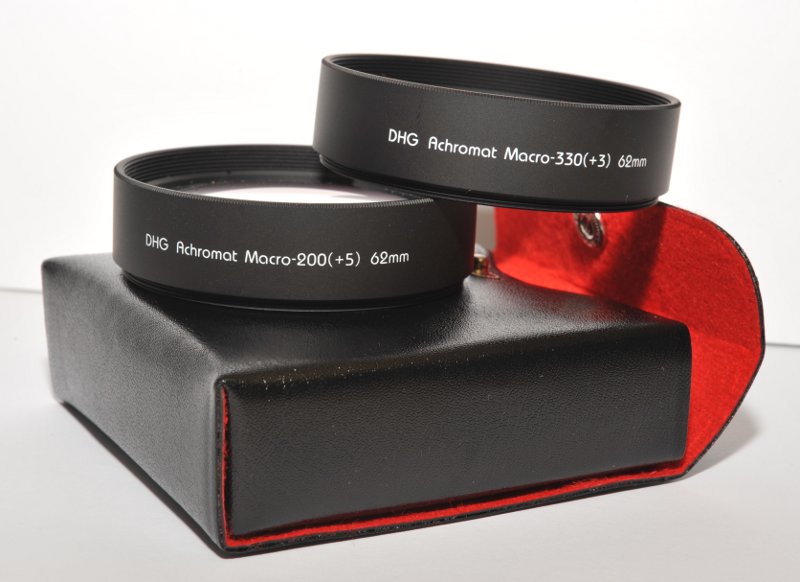

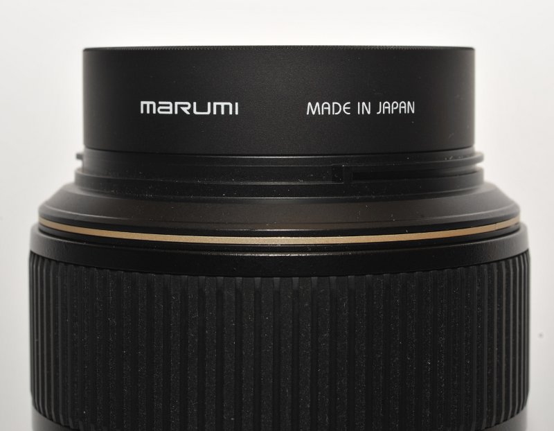

    I would like to use the Marumi DHG Achromat Macro 200 and 330 with my Nikon 105mm VR. What Subal flat port do I need? As most of you Subal owners will know, the dedicated port for the Nikon 105mm VR is not long enough if you want to use a diopter. :(
    This is where I bought the Marumi Macro 200 and 330: enjoyyourcamera.com
    You can get it also here: microglobe.co.uk
    Both Marumis add about 16mm to the length of the Nikon 105mm VR when screwed in
