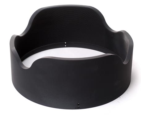

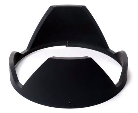

  6. post-1676-1255915845.jpgpost-1676-1255915756.jpg just to clarify, the Wide angle dome shade # 18482 (the thicker one on the right) will show up in the picture with fisheye lenses,
    the Fisheye dome shade # 18480 (the thinner one on the left) will not vignette, Damien what you have is a Fisheye dome shade not the Wide Angle one.

  8. post-1676-1255915845.jpgpost-1676-1255915756.jpg just to clarify, the Wide angle dome shade # 18482 (the thicker one on the right) will show up in the picture with fisheye lenses,
