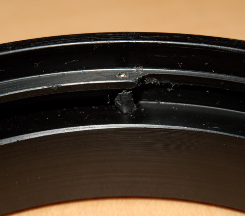

  1. I just picked up an excellent second hand FE2 dome port here on Wetpixel. I also bought the 18/3 extension ring to be used with my Tokina 10-17mm. This is my first Subal rig and should the port be able to rotate 360 degrees in the extension ring? The extension ring locks into the housing fine and so does the dome port without the extension ring. I am worried that with a little bit of bad luck this could rotate off during a dive. Any tips to prevent this from happening? I thought this has been discussed but couldn't find the answer.

    The port should lock with a 90 degree turn to the extension ring just as the extension ring rotates and locks onto the housing. The shade should snap onto the dome and be secured with two small hex screws on either side (top and bottom) of the rim. It is an important habit to get into with Subal to check the alignment and rotatation of the extension and port before getting in the water. I do this by making sure the labels on the ring and port are aligned at 12 o'clock TDC with the housing during assembly, before and immediately after entering the water. They can and do rotate, and I've witnessed a flood (not mine) as a result.
  3. This is my first Subal rig and should the port be able to rotate 360 degrees in the extension ring?
    No. You have lost the pin from the threads that stops it after a 90 degree rotation. You should get a replacement pin. I'll post a picture.

  4. No. You have lost the pin from the threads that stops it after a 90 degree rotation. You should get a replacement pin. I'll post a picture.
    Alex
    Perfect, thanks for the information.
