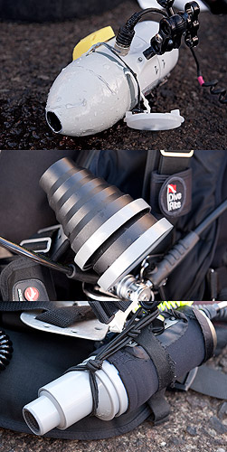

  10. Here are some of the snoots I photographed at the El Hierro Open Fotosub. I think that those are yours in the middle Pedro
    This event is definitely one of the most rewarding fotosubs and also has the strongest competitors and v. good prize money - first place was $13500 USD cash. So photographers really go to great lengths to get the edge in their photos. Most prefer home made snoots, rather than off the self ones - to get exactly the spot size they want for a particular shot.

  12. That´s right, Alex, the ones in the middle are mine!!!
    But those are the ones I modified for my seacams, that will screw in front of them...
    Here you have how the SV will have to be cut to fit the Inons, with a different system, as commented above:
    What you see standing by are a couple of PVC reductions (50 to 32 and 32 to 20 -european size-) that will fit in the snoot without any need for machining, so you can effectively reduce the beam angle (also function of the lengh of the snoot itself -longer now and therefore helping to narrow the angle even further-) and the distance flash-to-subject
    Here you can see them mounted:
    The final diameter is a little bit smaller than a one and a half liter Coke bottle´s cap, as you can see in the photo.
    I am pretty sure you can go even narrower with further attachments, but I found that careful placement of the flash usually is enough for getting the desired effect.
    In fact, I´d rather prefer this system because, by carrying the PVC bushels in my BCD´s pocket, I am also able to have a wider beam should I need it; keep in mind that snoots are not only useful for macro!!! (this photo made finalist in the BBC Wildlife, portraits category):
