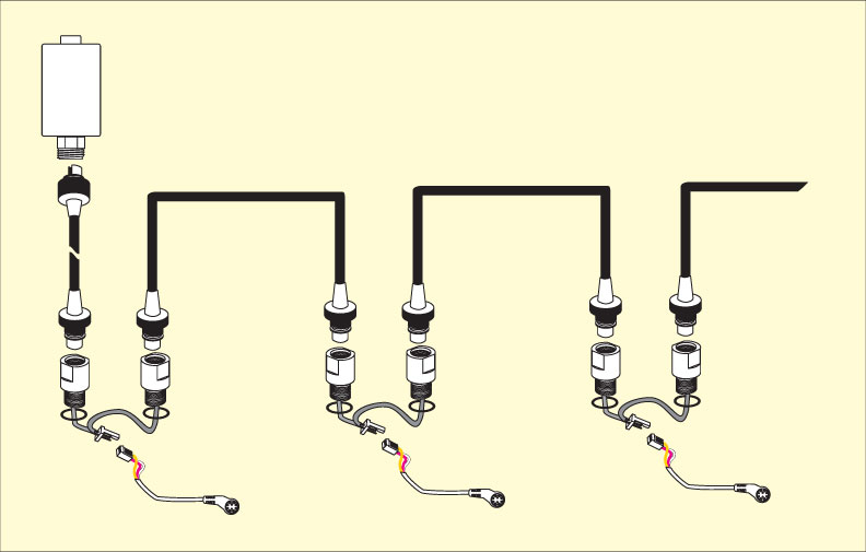

    You could use two of our remote internal cords and use a Nikonos to Nikonos (Fantasea had one and one of the European srobe manufacturer does also) cord to connect two housings together and they would trigger at the same time, now someone willing to do a bit of soldering coud add two bulkheads connectors joined the same remote internal cord, one in, one out (sort of a SCUSI chain) so multiple housings could be linked together, if Nikonos to Nikonos cables are too hard to find, the principle could be applied with Ikelite standard cords since they have identical end and could be extended an extra 3ft or even 15ft of the actual lenght with off the shelf extension.
    BTW you only need 2 wires for triggering multiple camera
    Edited by Viz'art
  11. Here is a quick drawing on how I would do it.
