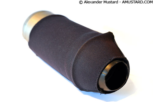

  1. Ok, after many folks have asked, here is a couple shots of my snoot. Sorry about the lens choice for the photos, was too lazy to go get a wider one :wacko:
    Its basically a 1.5 litre water bottle cut in half with two slits cut down the side to fit over my YS120 strobe, the opening of the bottle is where the light comes out. I then duct tape it in place and all over the bottle to ensure no light comes out. The opening that you see on the end of the it is actually a smaller bottle that i have cut and slid onto the end of the water bottle and then duct taped in on there as well. The opening is approx 1cm across, quite small. Good for snooting a pygmy actually as the water bottle opening itself is too wide. I can take the smaller bottle off underwater if i want a larger beam. It may look ugly.. but it works and the duct tape holds forever as long as it doesn't get banged. There is no snoot on the second strobe so i can use that if i need a full powered shot.
    Total cost.. $3 maybe?!
    However, don't try to use it with a 105mm and 2x teleconverter on a pygmy when there is a lot of surge in the water.... hahaha.. that was 45 mins of endless frustration this morning :goodpost:

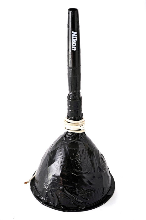

    Which is a lot easier that the fine beam Mike is using - which takes some real dediction. For macro I use a Nikon pen for the final attachment - (I am still waiting for someone to ask if it is an official Nikon accessory) - which is on the same size funnel as the photo above:
    That said, I feel my current design is loosing too much light. I am looking for a more light efficient solution (will report back if and when I get a break through).

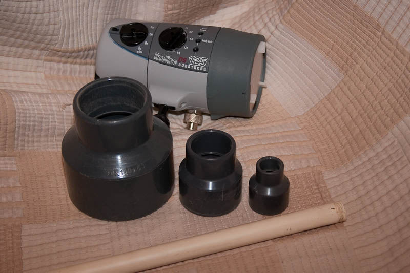

  12. Read Keri's article and loved the images.
    Headed off to the local 'plumbers merchant' and in my finest arabic whipped out my laptop, pointed to the picture of Keri's setup and said 'Same, same?'
    Man says 'what for?'
    'camera'
    'NO'
    Point again and say 'Same, same? No camera...'
    'Yes'
    Oh the joys of Egypt....

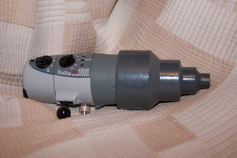

    Anyway, head off to the back of the shop and watch the chap shin up the shelving and starts throwing things down at be from the ceiling, Jackpot!!!
    A series of drainage pipe reducers that will stack into each other allowing the opening to be varied. Only downside is that they are a little heavy duty!! But the walls are thin enough that the outer edges can be shaved down.
    With then all stacked they have a nice interference fit and no light seems to spill from the overlaps. A tug and a twist and its removed. The entrance for the strobe needs to be opened up a few mm for the strobe to slide in but looks promising. The final diameter also fits poly-pipe so different lengths cam be accommodated.
    So 1 m polypipe and enough sections to kit out 2 strobes = 48 egyptian pounds (3 1/2 beers) about £6
    Will try and fit it properly tomorrow and go out and play....
    Thanks Keri, you picture of your setup was far more effective than the usual 'crayon' method of ordering parts..........
