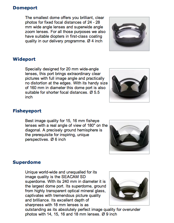

    James - I have my doubts that the smaller dome port will work. It will probably vignette, but I'd love to hear your experience as I don't have one of those ports to try it myself. The wide port, as per below, is the one I tried.
    The focal lengths mentioned refer to full-frame cameras. Also, in my experience the fisheye port is terrific for Nikon fisheye lenses but not as good for Canon 15mm. Must be a difference in nodal point. For my Canon 15mm I like superdome and wide port.

  12. Nice shots guys! FWIW I have used the WP with the Nikon 10.5 and got just a tiny bit of vignetting at certain focused distances. This was before I got the FE port. Since the WP, SD, FE are all domeports, I find the Seacam nomenclature for the 4" ports somewhat vague. I prefer to think of them as mini-domes. I have one of these, not sure which one, and used it with OK with the 14mm on DX. Good for where it is too shallow even for the WP.
