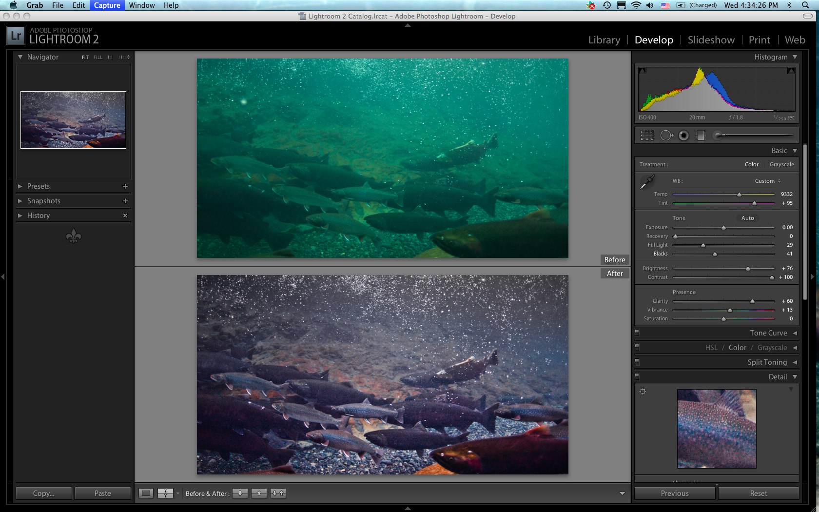

    You mention that your pix are too green. I am posting this screen grab out of Lightroom 2 showing before and after versions of one of my shots that had too much green. Look at the upper right - there are two sliders. The blue-yellow one is for the color temperature while the green-magenta one is called tint. This latter slider is adjusted to +95 units to correct for the green. Look for a similar control in your software. You may have to shift the color temp after shifting tint. I generally have to re-iterate adjusting both sliders several times to get what I like.
    This is a natural light shot. I wrote about it a bit in the available light thread. http://wetpixel.com/forums/index.php?showt...mp;#entry234476
    I also did a version in LR3 beta that is in post 163 of the thread

    Correct, there is a practical depth limitation to how much WB can be done even on a raw image such as I showed above, which was from near the surface down to maybe 3 m. It was well over 1 m deep where I stood (in waders) and pushed the rig in and deeper still where it was sitting when I took the shot, and deeper still in front of the lens.
    If one does a WB on a too deep shot to get rid of blue, one ends up with almost a black and white image. :D I have seen this as well when printing color negatives in the conventional darkroom.
  12. Whatever Mandrake is the link did not work, got 404.

  14. Thank you. But I don't use Lightroom, I use Photoshop CS2.
    Here is a screengrab of CS2. The tint slider is at +25.
