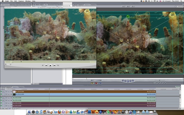

  6. I have attached a screen grab as an exaple, hardly any post on it at all, but you can see the two are different. Or could it just be the way quicktime / vlc etc display the clip?
    Render settings are all ticked, and i havent changedany audio etc on this clip.
    Steve - i's searched ken stone but not posted, i dont think i have time for another forum these days!

  7. When i export my timeline from fcp it seems to be ignoring my filter / composite settings and basically just spitting out the normal colour without any of my post work included. I've tried using Compressor and the quicktime export, both are the same.
    Are you noticing just the change in gamma or the issue as you said above? If it's not doing any filter or compositing at all, then throw out prefs and reinstall FCS. The gamma issue is not an issue if you use Pro Res.

  9. I have attached a screen grab as an exaple, hardly any post on it at all, but you can see the two are different. Or could it just be the way quicktime / vlc etc display the clip?
    Thanks for the input (except for Dean).
    In your original post you said you tried on the kenstone site but here you say you didn't. Now you have me confused.
    I agree, you might want to work in Pro Res, something I always do. If you have filters and transitions that are not showing in your output, you should trash prefs.
